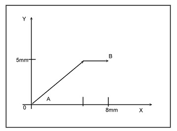

Point-to-point
(PTP) motion is the most basic form of motion control. It is used
when precise start and stop position is important, but the path
is irrelevant. In a PTP movement from point A to point B, the motors
for the Y and X axes will move at the same speed, so as you can
see in the diagram below, the motor for Y arrives at its destination
before X, and then stops. X still has to move 3 mm, so it arrives
later. The result is a path that looks like a broken line. But the
path is irrelevant in this example; it is the position that matters.

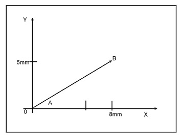

If you need more control over the path you can use linear or circular
interpolation. Circular interpolation is normally used in 2D applications,
while linear interpolation is common in both 2D and 3D applications.
For a 2D linear interpolation movement, you can use a vector with
the motion card's intelligent ASIC (Application Specification Integrated
Circuit) function instead of setting the speed for each axis like
PTP. The result is a straight path from A to B. The motors for all
axes will adjust their speed according to commands from the ASIC,
so no matter how far a motor has to go, all motors will arrive a
position B at the same time.

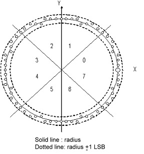

For
circular interpolation two synchronous motors follow a path that
is based on parameters for a circle: the circle's radius, start
angle and travel angle. The radius is the arc radius in counts for
servo axes or steps for stepper axes. The start angle is a number
between 0 and 360°, where 0 is along the positive X axis. Increasing
the value moves the position counter-clockwise along the radius.
The travel angle is the value in degrees to be traversed, so a positive
travel angle would mean counter-clockwise movement, while a negative
travel angle would mean clockwise movement.
