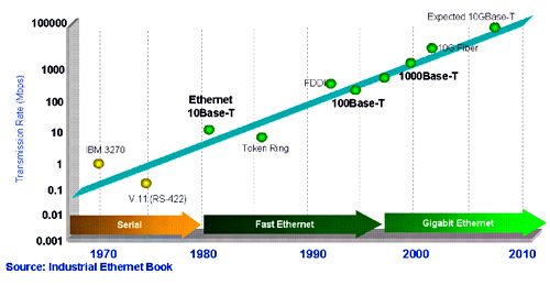

All of this is possible due to the continued advancement of Ethernet technology, and its tremendous commercial success. Standardized in June of 1998, Gigabit Ethernet offers similar characteristics to well known Fast Ethernet (10/100Base-TX), but it is 10-times faster. Initially deployed in local area network backbones and server connectivity, the decreasing cost of Gigabit Ethernet, has significantly expanded its use in recent years.
