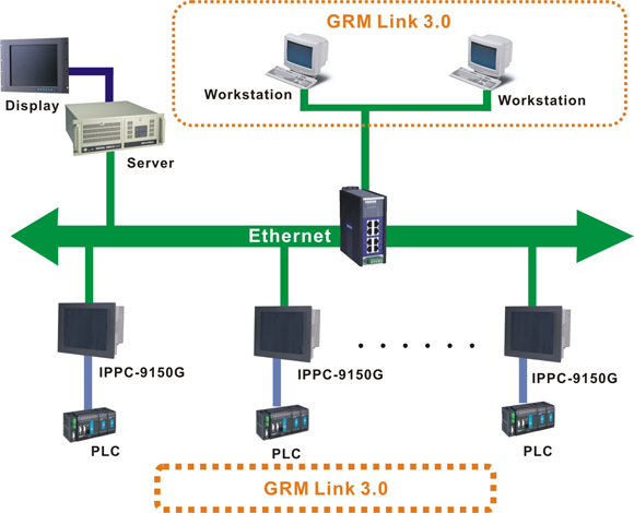

System Diagram:
System Description:
The host panel PC on the electrical control cabinet of the mudlogging unit implements functions of: 1) Detection processing; 2) Closed loop controlling; 3) Graphic report forms; 4) Recording; 5) Online adjustment; 6) Printing; 7) Alarming; 8) Statistical analysis; 9) Historical documentation; 10) System safety; 11) Web features; 12) User-friendly HMI.
The sensor monitors accidents such as pierced pipes, lost drills, lost bits, breaks, blowouts and slough. The monitoring parameters include: drilling load, pick-up weight, weight on hook, torque, stack pressure and flow.
Conclusion:
Adding Advantech's IPPC to this solution provided the following advantages: touchscreen display; all-in-one design; robust and durable with a wide temperature and humidity range, rugged design that withstands environmental conditions such as noise, high temperature, dust & vibration.
Intelligent control on the modlogging unit could be now implemented through the IPPC, enhancing the control accuracy of each parameter, saving energy, improving efficiency, lessening maintenance difficulty, strengthening project monitoring and accurately analyzing oil & gas status.
