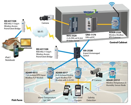

System Diagram:
System Description:
By using Advantech’s UNO-1170 din-rail pc with SCADA software, ADAM-4000 and ADAM-2000 remote I/O modules, the aquaculture system can be monitored and controlled continuously. First, the ADAM-2000 wireless I/O series products are in charge of the indoor temperature and humidity control with built-in sensors and transmit the data using the IEEE 802.15.4 protocol. Since ADAM-2000 I/O modules can be powered by batteries, they can be placed anywhere to acquire the data without the need of external power supply. Therefore, the area of the control system can be almost limitlessly extended.
As for the ADAM-4000 series products, the ADAM-4117 connects various sensors in the fish tanks to measure the water PH value, temperature, and CO2 percentage in real-time and the ADAM-4150 controls the pump, air-conditioning, humidifier, and sunshade to adjust the indoor temperature and humidity. All of those parameters will be delivered to the UNO-1170 din-rail pc via the RS-232/RS-485 converter (ADAM-4520) and the online status of the aquaculture system will be displayed on the screen.
